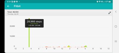

Screenshot_20210805-085438_Fitbit.jpgit happened to me,  too,  while sleeping!!
Welcome to the Fitbit Community, @Tammylt.
Thank you for joining the thread and sharing the details of the issue you experienced and a screenshot. I understand how you are feeling about this situation. I was able to see that you have already contacted our Support team regarding this, please continue working with them. I know they will be glad to help you out and provide a solution.
If you would like to remove the extra steps from your daily total, please follow the instructions in How do I delete steps and floors in the Fitbit app? I also recommend confirming if you have MobileTrack paired to your Fitbit account. MobileTrack lets you use the Fitbit app without a Fitbit device by using your phone's sensors to track basic activity data including steps, distance, and calories burned. For more information, see How do I use Fitbit MobileTrack? MobileTrack may add extra steps and I recommend removing it from your Fitbit account if you're not using it: How do I remove a Fitbit device from my account?
