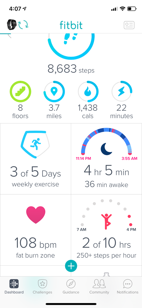

I don’t know guys. Today is not my day I’m super busy at work and I didn’t do all my walking.
The problem with the app is getting really upsetting. I update the app this morning with the new update and now I have another issue. My hourly activity is not synchronized properly. I’m not sure what to do. I delete the app restart my phone and the app telling me that I just walk 2 of my 10 hours.
App not workingApp not working
Real hours at my versaReal hours at my versa
@Aboy6 It needs to sync to from Versa to the servers (via fitbit app) and then back. It takes a while. Actually, my hourly activity always refreshes extremely slowly in the app. Tap on the tile to go into the detailed view. Let it sync several times and tap again. It should appear after the sync is complete.

Nop.
Still just 2 hours and at this point I’m really frustrated. I know this is something little but, I feel every update is something new to mess up the app and not improved.
I will try a way how to downgrade the app and stick to that version. The battery is sucking up like crazy again yesterday at the moment of the pictures of my post I had 72% of battery I have 50% now.

Thank you for sharing the details of the issue you're experiencing with your Hourly Activity Goal. I would like to confirm that our team is aware of it and we're working to identify a resolution as quickly as possible. I am sorry for any trouble. I appreciate your patience and look forward to getting you back on track.
