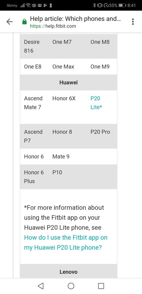

Hi Nelly. Before I purchased the versa I checked to see if it was compatible. As you will see below, the P20 Pro is on the list of supported devices. The P20 lite has connectivity issues but I do not have this version. If the p20 pro does not work with fitbit, I would recommend changing your list. I bought the versa on the basis it would be supported.

Woops! You are quite right (sorry), the P20 Pro IS supported (must have missed it last time I checked). In thay case it should work better than it seems to be doing. I will flag your post for a moderators assistance, as I dont know what else to suggest.
