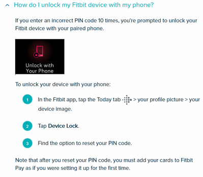

Hi, I'm using fitbit versa 2. It told me that I have to unlock with my phone but once I key in my correct passcode still it shows wrong. So I decided to remove the device in fitbit app and try to set up devices like new one yet it still shows me that I have to unlock with my phone. I even switched off the watch and try again but its not helpful. Now it's not even connected by Bluetooth too. Hope someone could help me on this. Thanks.

Hi. I have the same problem. I can't find : Your device image or Device lock. Please do explain some more. first today, then the picture and then?? please give me smal steps- Thanks
