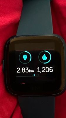

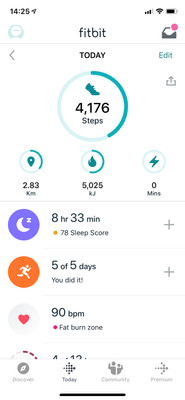

Thanks Lizzie, I followed each of your instructions, but nothing has changed. Please see the photos attached.

Hi @Sydgreco. I hope you're doing well and I'm sorry for the delay.
Thanks for the screenshots provided, they're great! It's odd that the units under energy update on the Fitbit app but not on your Versa Lite. Let's try one more thing together:
