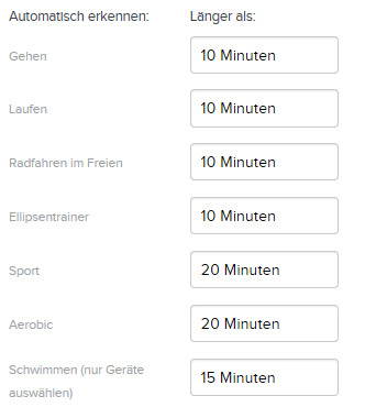

I wear the Versa on my left and the Charge2 on my right hand. My cycling in the morning just lasts 12 to 18 minutes. Auto recognisation for Cycling is set to 10 minutes, GPS off, AutoPause off.
If cycling last betweeen 12 and 18 minutes it is either not recognised or detected as "Sport". If it lasts about 20 min. or more it is dedected OK.

So on 5th I changed the auto rec. for sport from 10 to 15 minutes. Now it does not detect Sport but still no cycling either like today (9.7) dedected by my Charge2.

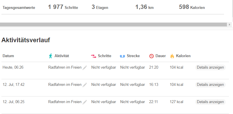

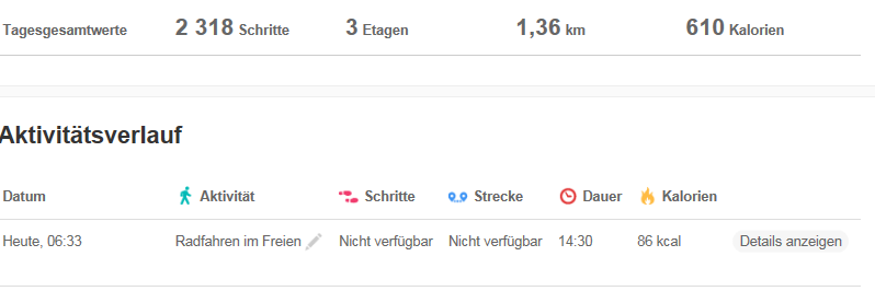

12.7. Usually the recognition works on my way home as it lasts more than 20min. Not so yesterday. The cause seems to be that I checked my steps on both trackers quite often.
To do this I had to take one hand from the handlebar and knock on the other trackers display.
Never the less the Charge2 detected the ride but also was about 7min. short.
13.7. CYCLING RECOGNICED: Today morning I tried to take the hand with the Versa from the handlebar every time I saw bumps on the street. Just to say: I AM RIDING ON A PAVED STREET not of track.
This way the Versa worked and has the correct start time and duration.
The Charge2 sometimes like today already starts 7 min. early when I walk downstairs to my bike.

Versa
Charge2
