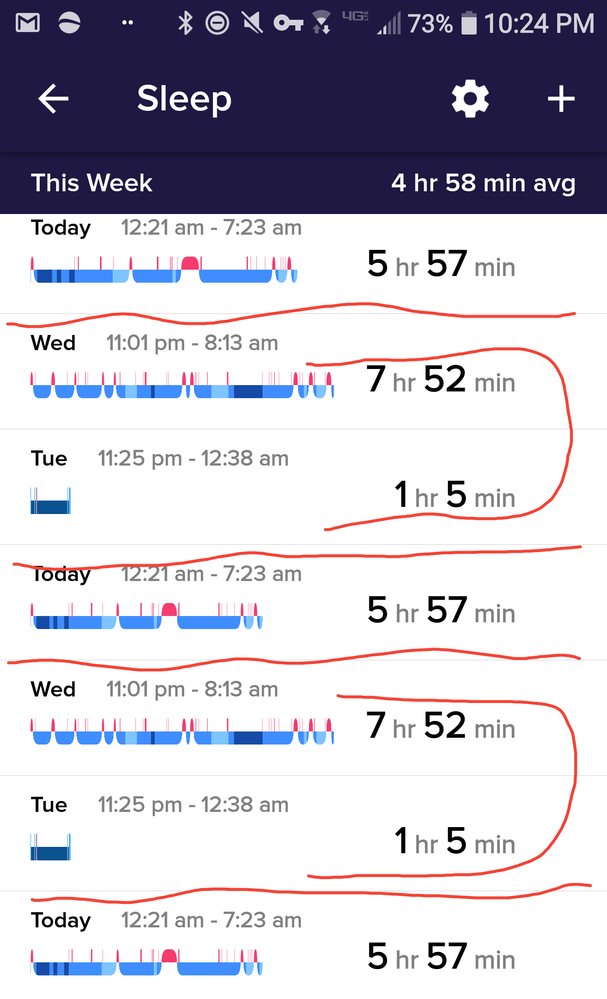

2. I have taken a screen shot, shown below, of some sleep recordings:
I accidentally deleted the "companion" session to the one for Today 12:21am - 7:23am. This was my attempt to clear out what appeared to be duplicate entries in this screen. You'll see those as you go through the screen grab, and I don't know what is causing the duplicate records at this point. There was previously a "companion" session labeled Wed that started around 10:30pm and went till near midnight, that later continued with the Today session.
The two entries labeled Tue & Wed are actually one sleep session across midnight. I'll be checking again in the morning tomorrow what gets recorded and posted.

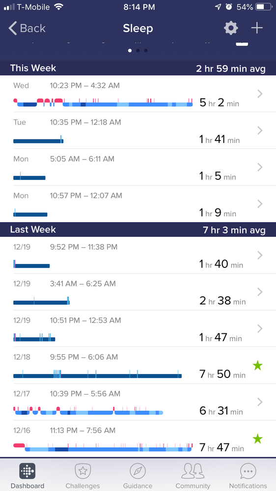

Mine seems to be doing the same thing over the past few days. and funny thing, I had my Fitbit charging last night but still detected a sleep pattern 🤔

@Marrrmaduke Hi I’m using 33.1.30 and yes I believe it happened after the update. I also just realized it didn’t detect any sleep pattern from the 20th to the 23rd.
