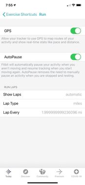

The exercise cue has gone crazy. The FitBit app keeps changing my exercise cue Laps from 0.5 miles to 1.9999999999236096 and then sync my Versa 2 to 2.00 miles. Yet, when I look at the website, the cue still shows 0.5 miles.

The watch changed to 2.00 mi / lap and app changed to 1.999999999999236096 mi under Exercise Shortcuts.
This is a repeatable Bug.

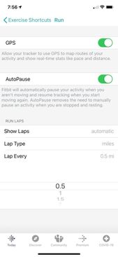

Watch reset on its own
What the phone app showed
I reset to 0.5
After a sync the phone app showed
