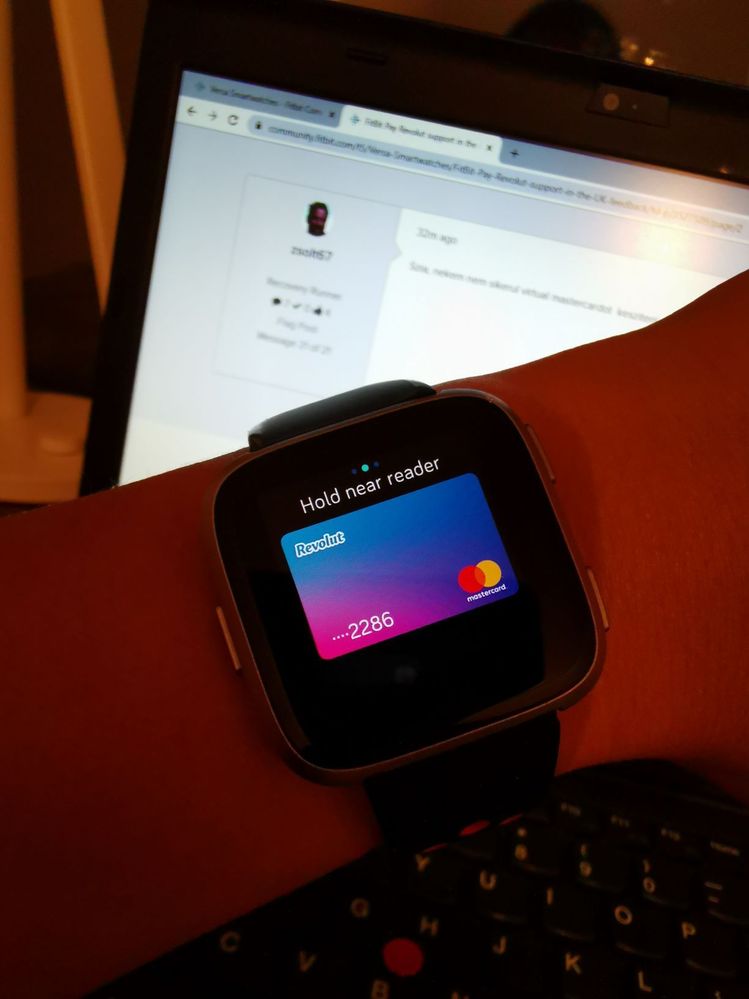

Revolut works on my versa. Suggest you try to switch your location in Fitbit App to US or Switzerland instead of UK by tapping your portrait there.
Well I have a charge 3 but did as you said. I changed the settings to the US and  managed to add the card to my wallet. Will have to go out and confirm it works!
You are absolutely right!
After changing the country to the United States, the card suddenly works.

Yessss, worked a treat. Set to the US, added my Revolut virtual mastercard card on on to fitbit wallet then had to go out and test it with a pint of Wye Valley Brewery HPA. Supping on it now. Great find okey2k. Revolut works in the UK!

I was able to set up my Revolut card on Fitbit pay today without having to change the country to USA. So it appears that the linking issue is fixed across the board now.

Hi, since we are 1.5 years later this probably does not help, yet just to let you know I just now without any issues linked up my free virtual revolut card with Fitbit pay, I am UK based. Good luck.

I can confirm that my Charge 3 works with both Revolut Visa and Mastercard without problems. I have however ditched the Charge 3 since the display is now so dim I cannot use it anymore. I belive this is a common problem with the Charge 3 just as the cracked screen on my Charge 2. It's a pity fitbit can't make a watch that can lasts more than a year but that's another topic for discussion.

After much searching managed to find a solution for this, well at least for me.
it would appear the only Revolut cards that you can link yo Fitbit Pay are Mastercard, but they need to be physical cards not virtual ones. I tried linking virtual Visa cards and nothing worked, tried the suggestion of changing location to USA but this didn't work either.
Tried to link a virtual Mastercard, this failed too. Ordered a physical card, a Mastercard, activated it and it linked first time to Fitbit Pay, no issues at all.
So (at least for me in the UK) the solution is to order a physical Mastercard (cost me £4.99), activate it and then link it to Fitbit.
I am using a Charge 3 HR
Hello UK  Fitbit owners. If you have Revolut card make sure you choose the card skin that shows MasterCard when you order the card. Revolut offers both VISA and MasterCard card skins when you order your card. Choose Mastetcard and this will work with Fitbit Pay. I have both VISA and MasterCard Revolut cards but only the MasterCard one works with Fitbit Pay.
