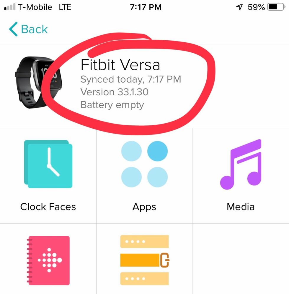

Thanks for your reply. Yes I’ve looked at this as well. It seems to be syncing normally without issue through the app. Still no updated info on the versa itself...
So does that mean you did check what is says for the last sync time, and it was recent?
Correct

I'm in favor of anything that works, but I'm baffled how it would update its last sync date if it didn't have wi-fi connection.
Your guess is as good as mine! I love my versa, but I often have frustrations such as these.
That’s the last time it successfully connected to WiFi. Everything else gets a strong WiFi signal in all but one room so I know it’s not the router. I’m not sure the repeater will help since I stood next to the router and it lost the connection about halfway through syncing. I purposely did it while no one and nothing else was even using WiFi this morning. It took several attempts to set it up when I bought it. I guess that should have been my first clue. But I didn’t think anything of it because my charge2 updates with Bluetooth. I hadn’t read everything yet to see that versa needs WiFi for complete updates/sync.
If you're working, or expect to be soon, don't let me confuse the issue.
I was referring to the OP's phone app showing last sync time.
The Versa does not need wi-fi to sync, but the phone does.  Data goes from Versa to phone via bluetooth, then phone communicates with main fitbit database via wi-fi (or maybe it could via phone data transfer), then back to Versa from phone via bluetooth.
