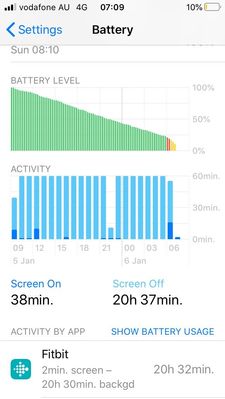

I have an iPhone 6s using iOS 13.3. Last night I went to sleep with my phone around 90% of battery. I woke up this morning and my phone was completely dead (luckily before my alarm or I would have been very late for work!). On the battery tab in settings it seems the Fitbit app was using battery all night in the background, for nearly 7h which completely drained the phone battery. The app wasn’t even open on the phone overnight (I had swiped up to close all my apps before bed) and I seem to be have issues syncing with my Versa. I assume the battery drainage could be from it trying to constantly sync all night? My Versa also seems to be not holding charge well recently and I updated it’s software recently too.

Hi @CharlotteBell, It's nice to see you again participating here in the Community Forums, welcome back!
Thanks for bringing this to my attention and for the details that were shared in your post, the screenshot attached was helpful for me to better understand this situation, seems odd that your Fitbit app was working on the background for that long. To better assist you with this, can you please let me know when was the first time you experienced this and how many times since then? Do you have All-Day sync feature enabled? If you haven't already done so, please restart your Versa following the next steps:

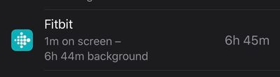

I just got the Versa 2 and it is draining my iphone battery too. I turned off background and all day sync. But it is still running in the background for 7 hours a day.

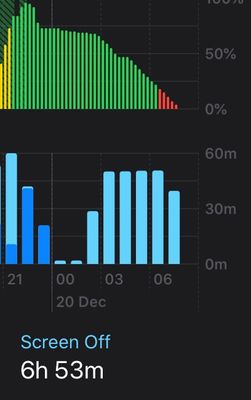

I’ve had the same problem since my Versa was updated in December. I don’t have the same issue with my Charge2.  Yesterday, I didn’t use the phone  at all and it was 100% charged. This morning it was at 17%, with Background App Activity draining the battery.
