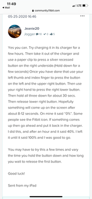

This happened to me too. If you have had it less than a year, you can get a replacement. If you have had it longer than that, all they will do is offer you 25% off a new device unless you purchased the extended warranty. However, I did a lot of searching on these forums and found a solution that brought mine back to life. The sleep function is acting wonky but everything else is working. It’s worth a try.
This worked! Thanks for the info!!
