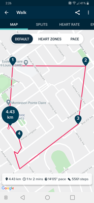

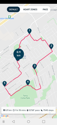

 This is what I'm getting.
It's like it checks in at each kilometer marker
That is weird looking but shows a break in the gps signal.
