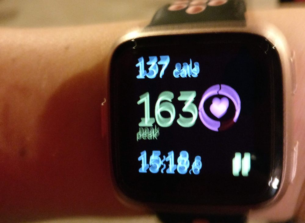

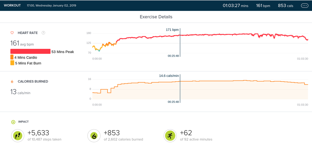

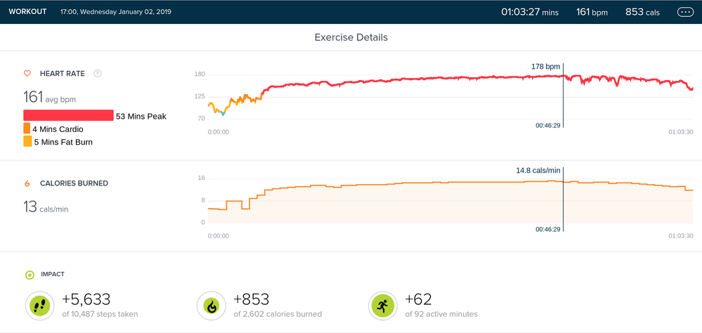

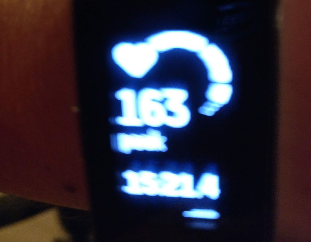

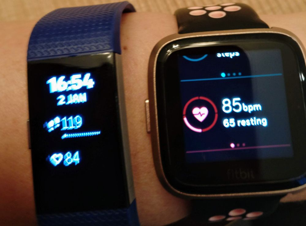

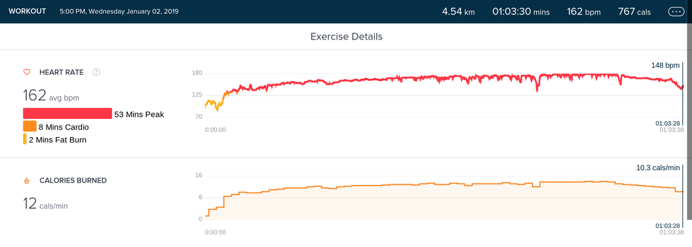

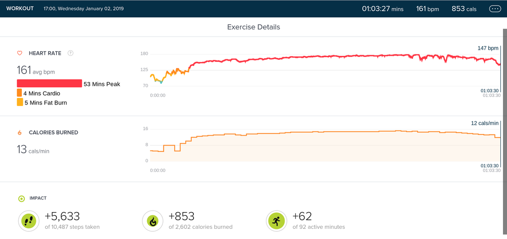

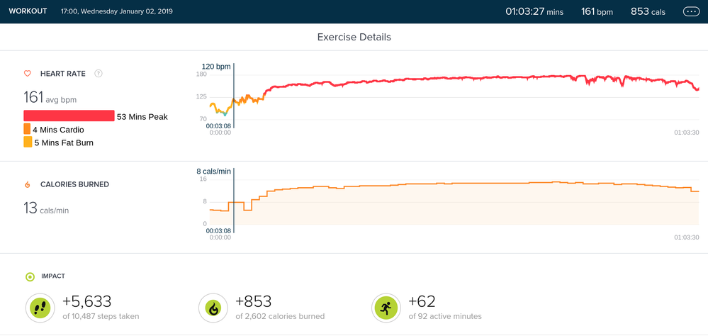

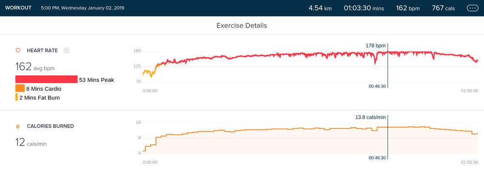

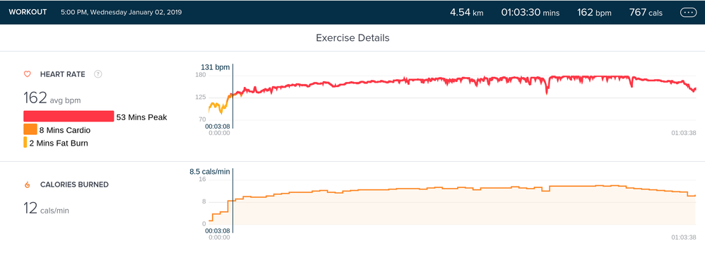

@lenny4d Hope you survived the first hump day after the long weekend. 😄 Remember how I told you I did not see the differences that you obviously had seen between Versa and Charge 2? So, I decided to replicate your experiment while working out today (cross-country skiing machine, avg 7 km/h speed, 7 km distance, visual HR monitoring each 15 seconds on both trackers, screenshots of full recordings attached). Takeaways:
  • when visually monitored, both trackers displayed literally the same or very similar HR (+-1 bpm)
  • Versa did way better with my tendency to sweat a lot. Had to briefly wipe it only once whereas Ch2 required numerous wipes throughout the session. It is important as CH2 tends to drop HR recording when there's a puddle of sweat under its sensor. One can see a brief drops in HR in a few places on the charts just because of that
  • both trackers produced extremely similar bpm curves, the same average 162 bpm and very close max bpm of 180 and 179 for Versa and CH2, respectively
  • also, before exercise bpm was similar as well
I am attaching HR recordings and a few pics of displays taken during and before workout (sorry for the poor quality!)
Charge 2 Pic 1Charge 2 Pic 1Charge 2 Pic 2Charge 2 Pic 2Charge 2 Pic 3Charge 2 Pic 3Charge 2 Pic 4Charge 2 Pic 4Versa Pic 1Versa Pic 1Versa Pic 2Versa Pic 2Versa Pic 3Versa Pic 3Versa Pic 4Versa Pic 4Before the workoutBefore the workoutCharge 2 @ 15 min 21 secCharge 2 @ 15 min 21 secVersa @ 15 min 18 secVersa @ 15 min 18 sec
