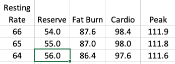

Yes the zone breaks will change when your resting heart rate changes, but not by much.
My RHR recently spiked a bit, probably due to the mini-heat wave we are having in SoCal, from my normal (like 95% of the time) 63 to 66 on Thursday and is back on the way down.
You can see the historical values by looking at your exercise records' heart rate graphs (be advised that some individuals are reporting the graphs and zone definitions missing). From a Thursday exercise record:
Thursday, with a RHR of 66, the zone breaks were 87, 98, 111
Friday, with a RHR of 65, the zone breaks were 87, 98, 111
Sunday  with a RHR of 64, the zone breaks were 86, 97, 111
If you never hit peak then the peak value will not show. I had a session with a max of 109 and all I got was 87 and 98.
Of course you could always just tap on the gear icon after tapping on the heart rate tile in your mobile apps Today screen each day. Just make sure you just look and then press "done" or you could reset your custom Max HR and have to go back to the Web Settings page, which isn't always guaranteed to work.
FitBit apparently, instead of rounding decimal fractions to the nearest whole number, uses integer values instead. For instance, in Excel, the one-digit decimal fraction values are:
Like I said, not a large change from day to day, if your RHR fluctuates.
