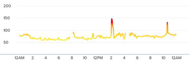

Minimal Activity (looks ok)

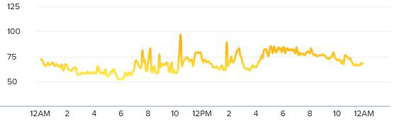

Walking (random spikes)

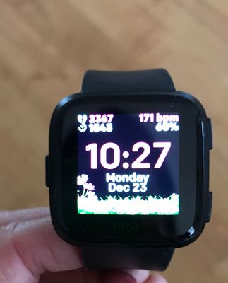

 This has been off my wrist for 5 minutes, showing 171 bpm. Before I took it off my wrist I lightly jogged across the living room, which normally might be 80-90 bpm at most. It’s like taking $200 and setting a match to it.
