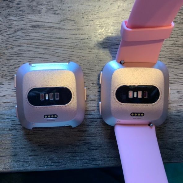

After hours and hours of conversations with fitbit several different times, they finally agreed to replace mine. I started getting readings double what my actual heart rate was when I first got it lightly wet while washing it. I thought it was coincidence. The sensor on the back looked different to me. Like they were changing colors or fogging up. Had nothing to compare it to so thought it was all in my head. Since it was broke anyway, I decided to get it wet again. Just lightly to wash it. It should have been ok as they claim it’s swim proof. Then the sensor light started acting up and a day later was completely out for good. When I got the replacement and compared the sensors it was clear to me this is a hardware issue. I will be keeping my replacement far from water and hope there isn’t a hardware AND software issue. I am attaching a picture in case others notice this too. The one with the strap where the two sensors look pink is the defective one.
Am having the same problem with extremely high BPM readings. Interesting that it happened after camping I left it on to shower whereas I normally remove it at home. Some of these units are obviously less water resistant than others. End result is that I am not sure if it is software or hardware problem. Now to find my receipt and start the onerous task of trying to get fix or replacement.....
