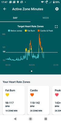

After the most recent update my zone minutes are not added up correctly. Although the graph and Average heart rate show that I reached cardio and fat burn levels of heart activity (shown in orange and yellow), all minutes are shows as below zones. I have an iPhone 11 and a versa 2. All devices are updated. I’m not concerned with with small gaps in data but the minutes do not add up correctly in reference to the graph. This happens even when there is no gap in data.

Just done the firmware update and got the change to active zone minutes. Mine shows a total of zero for today so far but the graph shows this
The zero is obviously wrong. I would revert to the old active minutes but can't see how to.

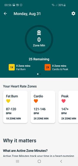

Hi,
On my Versa 2, Active Zone Minutes seem to stay at zero, even if I do some exercise and heart rate is in the right zones.
Any ideas why???

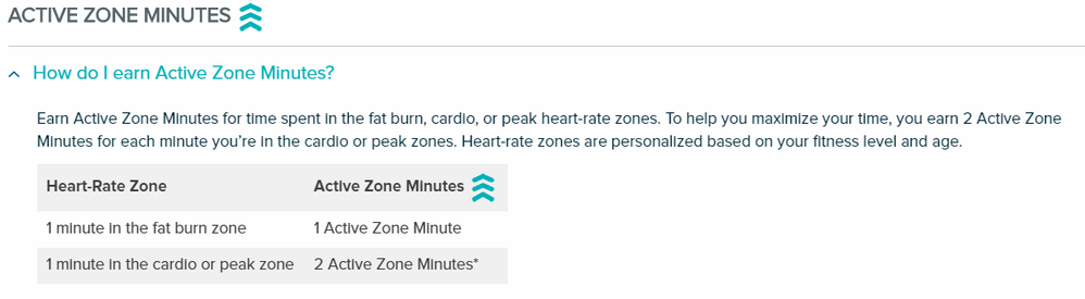

@Yardoh @SunsetRunner Yes, heart rate does affect AZM now. I barely get any AZM compared to active minutes. Here is the help article on AZM.
You've really got to get your heart rate up into the fat burning zone to get AZM. I wish I had the choice between active minutes and AZM, but unfortunately not. AZM is what we have now.
