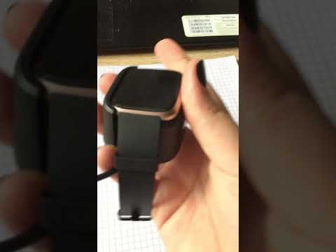

I just see a black screen or just fitbit logo... their guide to restore it is useless... it's really a hell 😞
So my versa is with black screen or fitbit logo frozen... nothing else... but I see other people lately having same issues:
https://www.youtube.com/watch?v=z8zkE20NSmE
https://www.youtube.com/watch?v=cbkQuslaTgY
I'm tired of trying to push the 3 buttons... nothing happens, I don't see any reply from support here in this thread... very disappointed 😞
