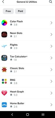

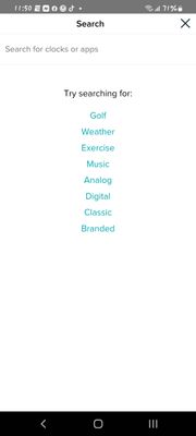

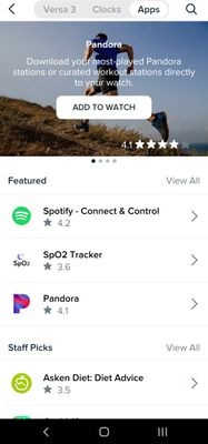

I tried all your suggestions didn't work.
However, if you go into the Gallery.
Next click on Versa 3 Clocks APPS ( CLICK)
Once it pops up with different selections scroll down to General and Utilities in the Search bar scroll down and click weather this ( click on whichever weather app you are using) this is where you can change from Celsius to Fahrenheit.
Note: I have an Android phone however, should be able to utilize even on Iphone.
Good luck!
