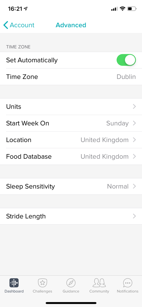

1. I do not see a swimming tab under Advance Settings and can not change the pool length.
2. I have a Charge-3 and there is no option to change pool length on the device as far as I can tell.

Hi @Nadav, welcome to the Community! In order to set the pool length on your device, you have to do the following:
- On your device, open the Exercise app > Swim
- Swipe up from the exercise screen and tap Pool Length
Please send me a screenshot of your App where the Advance Settings are. Normally you should be able to find the swim settings at the bottom of the page.

There’s no swim under advanced setting.

Same issue here. Bought a Charge 3 specifically for the swimming tracking and very frustrating that it is not accurate. All the swim settings in advanced settings do not exist and swiping up when in the swim app on the device does nothing.

For the Charge 3, it is NOT in the app, but on the Charge 3 itself.  Be sure to have Swimming set up as an exercise.  Follow these steps:
  1) From the main screen, swipe left to see the Exercise Icon.  Tap it.
  2) Swipe right/left until you see the Swim icon.
  3) Swipe up.  There you will see Pool Length and Units.
  4) Tap Pool Length.  Swipe up or down to adjust the length of the pool.
  5) Press the button on the left side of the watch to save and exit.
That should have modified the settings for pool length.
