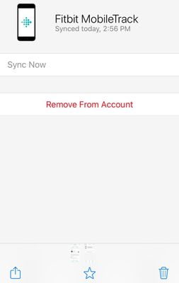

@Sazan Just to make sure, is your fitbit still linked with your account (can you see it in the fitbit mobile app)? When was the last sync?
Marrrmaduke | Canada
Charge HR, Blaze, Charge 2, Charge 3, Inspire HR, Versa Lite, Versa SE, Aria
Hello
how do I find out about when was last synced
show me the steps please?
@Sazan open your Fitbit mobile app and tap on your profile picture. Scroll down to Versa. It should say there when there was the last sync.

@Sazan Thank you. I can confirm Versa is not linked to your account. At this point there is no way of unlocking it. You can attempt button factory reset. If this does not work, you will need to ship your Versa to Fitbit. Here's the link to Customer Support page.
Factory reset using buttons:
For Versa 1:
  1. Press and hold all 3 buttons until Fitbit logo appears (this may take up to 3 minutes)
  2. Release the bottom right button
  3. Wait until you feel strong vibration and release the other buttons.
You may need to attempt the reset a few times to find the optimal times. Trying holding the buttons longer, as long as it's needed for the vibration to appear.
For Versa Lite and 2:
  1. Hold the back button for about 8 seconds.
  2. When the Fitbit logo disappears:
    1. Release the button briefly (for less than 2 seconds).
    2. Hold the button again until you feel a second, longer vibration, which indicates you initiated the factory reset.
You can set up the watch back to the Fitbit account by following the instructions on this link: How do I set up my Fitbit device?
