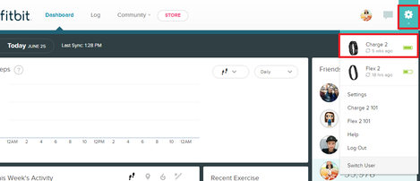

Hey @Bethgunn, let me give you a warm welcome to the Community! Don't you worry, to find this option, the sleep sensitivity, I will ask you to log into your PC Dashboard and from there, change the sleep sensitivity:
- Go to the Gear icon on the upper right corner

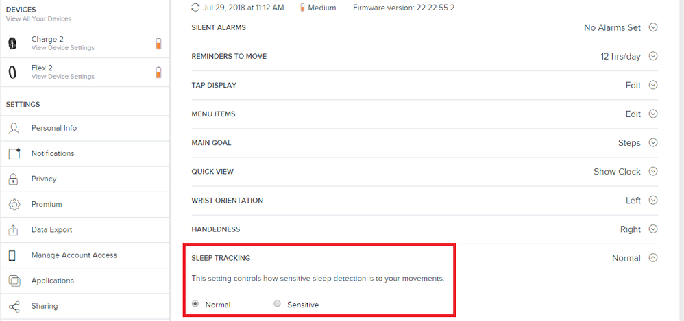

2. Scroll down to the "Sleep tracking" option
Finally don't forget to sync your Charge 2 to save these changes.

I thought the setting would be on the phone app, but instead it was on the the computer app, www.fitbit.com. Then click on the gear symbol in the upper right, then click settings, go down to Seleep under Advanced settings, then click the ^ to change between Normal and Sensitive. Then click on the Submit button at the bottom.

What is the difference between normal and sensitive sleep setting?
"Your device's setting can record your sleep in either "sensitive" mode for extremely detailed sleep reporting or "normal" mode for a more basic idea of your sleep patterns. Note that if you use a Fitbit device with heart-rate tracking to detect your sleep stages, this setting doesn't apply."
