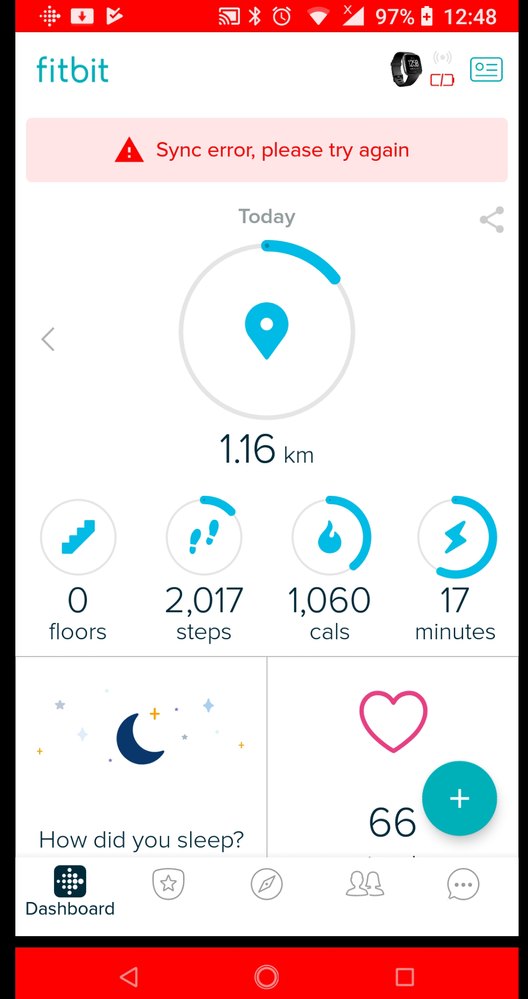

Strangely i can not see any answer from Fitbit as if it is not worth answering.Screenshot_2018-09-01-12-48-37~2.png
 This is a screen shot this afternoon spending half an hour trying to pair the watch after the versa gave my very good 3 days work and free pairing problems.
