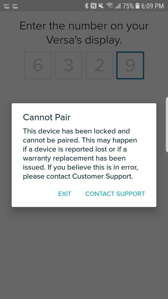

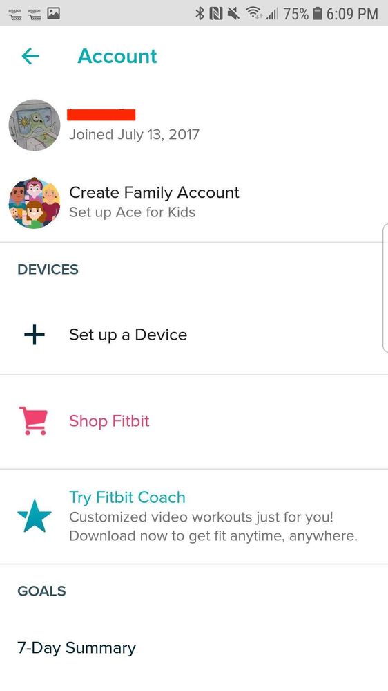

I received a versa special edition as a gift Thursday 4/18. I synced it up and it was working great. Saturday I logged into my app and versa wasn't synced. I restarted the app, turned the fit bit on and off, re-installed the app, and it still wouldn't show up. When I tried to re-add it I got a "can't add because it's reported lost or stolen or some warranty issue" I live-chatted and spoke on the phone during the time they asked me to factory re-set the device and then I couldn't use it at all. The night ended with me being told 24-48 hours for a response.
I still have not received an answer 10 days later. I have checked in and was told they're working on it and can't give me an estimated time line.

@Lazulis your screen shot is simply telling is that you have enabled the pin lock to lock your tracker,  and not just the wallet. This screen simply wants you to input your pin code fot the tracker.
Once the pin lock has been entered you will be fine.
Now if the tracker has been removed freon your account you will need to do a factory reset. This normally is done through the settings screen on the Versa but I don't think that you will have access to this. We will have to use the hardware method to do a factory reset.
On the watch, hold all three buttons for about twelve seconds. This triggers the 2-button hardware reboot after about eight seconds.
- When the Fitbit logo appears, then disappears, release the bottom right button, then continue holding the left and top right buttons until you feel a strong vibration. This indicates the factory reset was initiated.
- This process may take several seconds, and eventually, the Fitbit logo appears and the device boots and displays go to Fitbit.com/setup.
- If you fail to release the bottom right button in time, or otherwise don't follow the procedure precisely, the Fitbit logo reappears quickly and boots without factory reset.

Oh man! Now I wish I had just posted to the forum first! Thank you so much for your quick reply. I did the factory reset by going to the factory menu *not* holding the buttons- clearly this was an error on my part.
Anyway, appreciate the help! Cheers! It's at least linking and installing updates. I'll hopefully not have nay further issues.
