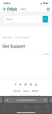

Ok today I tried to do this and now the watch refuses to turn on. I plugged it in to charge and  it just stays off so I’m unable to do anything apart from going in and out of the app in my phone.
more than likely the watch itself would have to be resolved and unfortunately this is actually my 2nd  replacement. So the issues seem to be a very consistent thing with Fitbit versa.
Even the website for Fitbit has glitches. It’s frustrating deal with this watch, app and the service on a whole. No info listed.
Hello again @Rose8mark
Try restarting your phone then try the Fitbit Customer Service link. I just tried it on both my iOS iPad and my Android phone and it popped right up. Yours might just need a quick restart refreshing. Just in case something happens the telephone number at Fitbit Customer Service is: 877-623-4997
