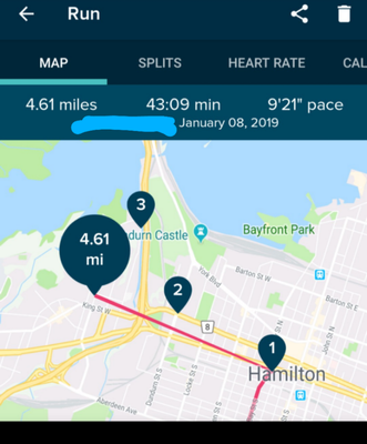

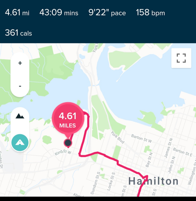

@Marrrmaduke So it's very strange, the proper route does not show on the app (but the mile markers are along the route). But if I go to the actual website it does show the proper route - see pictures below. The proper route also uploads to strava. However distance and pace are not accurate on the app or on the website - both underestimated. I am training for a race otherwise wouldn't care all that much. From reading in the forums it seems like a lot of people have this issue.

This is the map that shows on the appThis is the map that shows on the appThis is the map that shows on the websiteThis is the map that shows on the website
@nicoleproudft interesting very interesting. So, it seems Fitbit mobile app map needs to be refreshed. I have already seen issues with maps not loading properly. Since the route gets recorded when started on your Versa, then location services are running. It seems tho the info is not getting calculated properly and fed back to Versa. My best guess would be it's Fitbit mobile app bug. Nothing wrong with your Versa nor phone. It's the app or the way it communicates with servers and back with Versa. Just to verify, you are receiving notifications during your run and you have a decent wireless coverage for the internet? No net no calculations.
ETA: What's the proper length of the route? And what's the running stride length in your Fitbit app? I think the distance you might see comes from rough estimate based on steps and whatever running stride length is in your presets. It should be based on GPS. It gets recorded but not calculated.

@Marrrmaduke that run was off by about 0.5 km. Which doesn't seem like that big of a deal but makes a huge difference for pace. Since switching to pixel my "pace" has slowed enough to cause my cardio score to drop by 3 pts!
By i am fairly certain that the main issue is with Bluetooth though. My phone and Fitbit sync perfectly fine in general, but do not sync in exerice mode (i.e., steps do not even update when I am running for over an hour). And usually after finishing the run when i look at the app it says there is a Bluetooth error (or connectivity error, not sure the exact wording). I'm really not sure if the issue is even on fitbit's end - I've been reading that there are known Bluetooth issues with pixel 3 (not sure if it is Android Pie in general). For example, pixel 3 has problems connecting to 2 Bluetooth devices at once .
