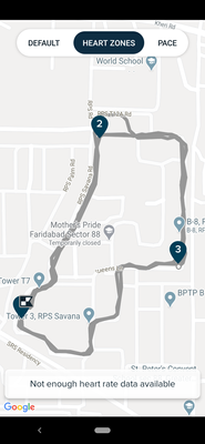

Hi when I try to use gps gps tracking (mobile track) while walking /jogging I do not see heart rate data in-app.
I see this is known issue but was it solved ?

Hello everybody,
As correctly mentioned by @N8teGee somebody might have an Alta HR for example and wanted to track a GPS section. Other possible good reasons somebody might want to track the session with the phone could be:
1) if the users wants to receive the audio cues about his/her run since the related suggestion has been closed as not planned
2) if, for example during an hike, the user wants to always check where he is on a map
3) if the users cares about real distance as it is proven the tracker provided stride calculation that can affect the result drastically
Originally this was possible and it is still possible in case of no GPS tracked session. For example if you do a Fitbit Coach session or a Fitbit workout while wearing an HR capable tracker the related HR info would be then imported into your session.
Apparently the feature has been removed purposely by Fitbit (see this article and specifically the following excerpt
Hello everybody,
Use the Exercise app to record GPS data for your workout. If you use MobileTrack in the Fitbit app, your heart rate might not appear on your device
As far as I understood the feature has been intentionally removed hence it is not considered a bug.
