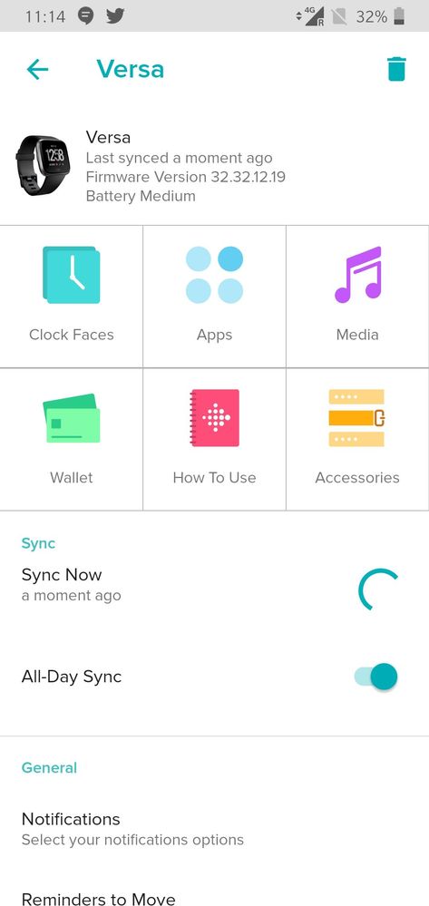

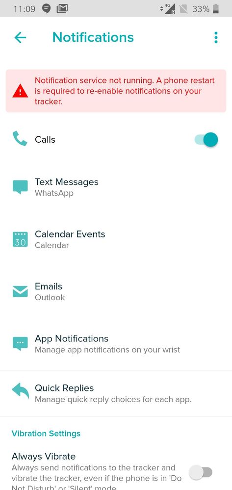

I have tried this all step and still,Screenshot_20181124-110923.jpgScreenshot_20181124-111416.jpgScreenshot_20181124-111443.jpgScreenshot_20181124-110923.jpg issue is not solved
@Jilin Your Versa syncs. It's the notification service that gets killed by Android.
A few ideas:
1. Make sure Fitbit mobile app is not being optimized by Android. Go to your phone's battery settings and disable battery optimization for Fitbit app.
2. Lock Fitbit mobile app in the background, so it doesn't get killed by Android. Please take a look at this link.
3. In the Fitbit mobile app, tap on Versa icon in the top right corner, and scroll down to Keep Alive Widget. Enable it. Also, enable always connected.
ETA: Usually points 1 and 3 should be sufficient.
