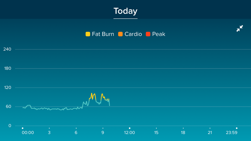

@Oanas Can you please take some screenshots of the heartrate recordings (in the Fitbit mobile app) for the nights Versa did not register sleep? Please post them here, so we can see if the issue is not related to HR monitoring.
Marrrmaduke | Canada
Charge HR, Blaze, Charge 2, Charge 3, Inspire HR, Versa Lite, Versa SE, Aria
I guess it is not related to missing HR. In fact, I check regularly when I am awake if the watch is registering my HR, as I am aware that some issues could be related to missing HR

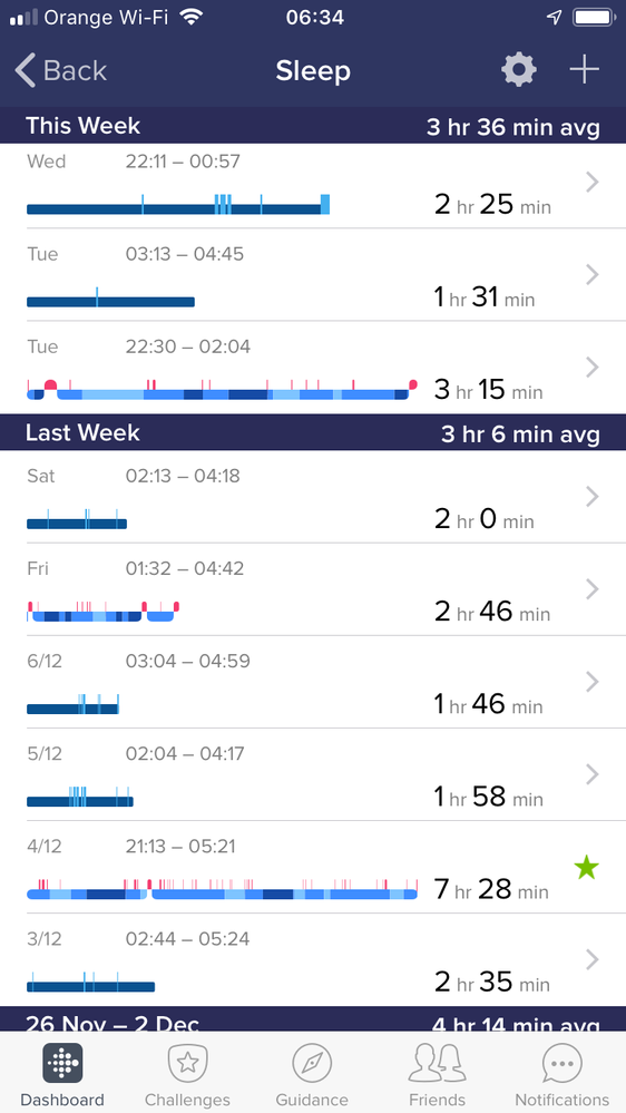

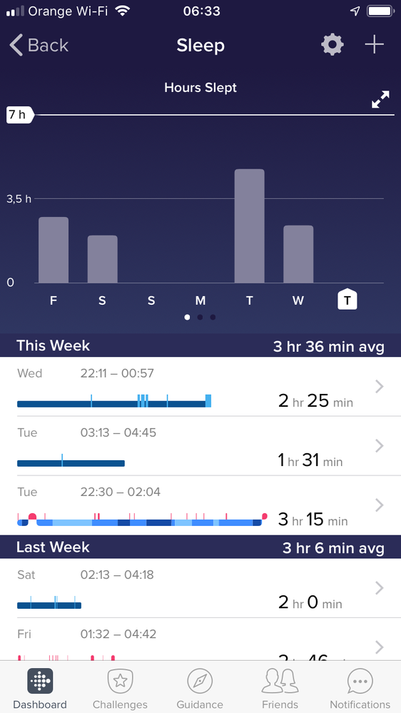

Hi, I have All day sync, always connected but the feature keep alive widget is not present in my app (ios). Please see attached the screenshots of my last 2 weeks. Haven’t done yet what you have suggested as the last thing to do
@Oanas I must have forgotten you're on iOS. There's no Keep Alive Widget there as simply it's not needed. Before you perform factory reset (as at this point it's the only solution left), out of curiosity, does your Versa recorded any activity like steps, active minutes for those sleepless nights? Basically, Versa needs you to stay motionless (or near motionless) for an hour to mark the beginning of sleep period. So I'm curious if it somehow is getting confused. Nevertheless, factory reset it is. Good luck.
