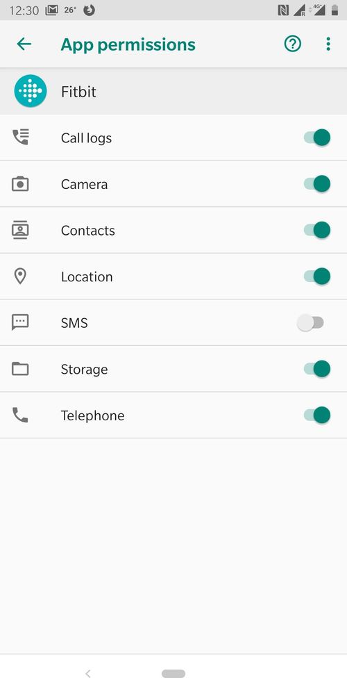

Hi Alejandra,
I'm facing a similar issue. I have checked the settings on my phone and fitbit app is having all the necessary permissions. Still when i select an exercise it always says connecting.
Not sure what to do. Can you please help in this regard.
