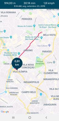

@LeoBueno Is the distance wrong only for biking or when you use Walking exercise as well? What is weird is that from Bela Vista to Vila Olipmpia is around 9 km and your map shows a proper route but 0.9km...

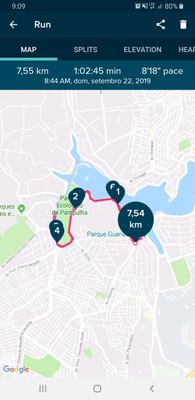

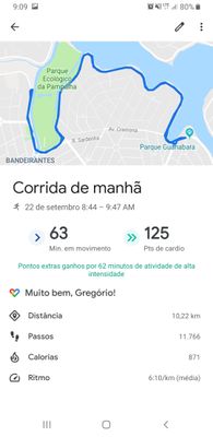

I'm having a similar problem. Fitbit registered 7,54 km while Google Fit registered 10,22 km for the same activity (which is correct).

I think this is happening since the last update, the GPS data is accurate but the distance reported by my Versa Lite is way below the actual distance, I usually run around 5.1KM and i get reports from 4KM to 4.6KM.
When I import the data to Strava I have an option to correct the reported distance using GPS data in there and I get an accurate value.
I'm using a Huawei P10 lite phone for GPS and Sync.
