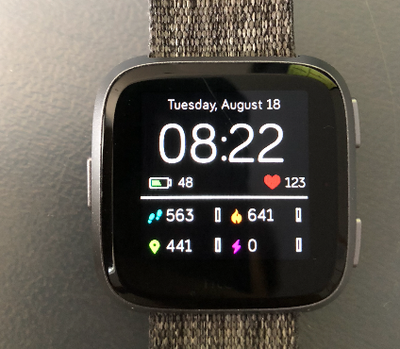

Dear Maria,
thank you for the information. Unfortunately it doesn't helped. Still on the screen of the device I have "123" numbers next to heart logo. By the way, after shut down my versa it doesn't wake up after pressing any key. I had to press and hold all 3 buttons.

Hi there @MichaelCz, thanks for the update and for the photo attached.
As a last resort, I'd like you to please try changing the clock face to a different one to see if the heart rate still shows "123" (try switching to a one developed by Fitbit). Also, please check the Fitbit app and see if it shows the "123" like your watch or if it's actually updating your heart rate as it supposed to do.
Changing the clock face would also help with the screen that is not waking up unless you press and hold the 3 buttons.
Give this a go and let me know how it goes.

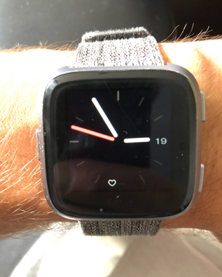

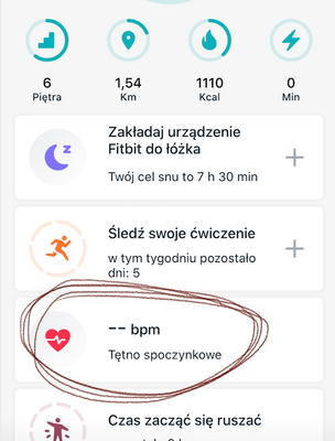

Dear Marre,
no data. I'm afraid that the HR module does not correspond.

Hi there @MichaelCz, thanks for your response and for sending those photos for a better understand of what you're getting on your watch and Fitbit app.
I appreciate you had followed the tips and recommendations provided above. Since this sounds a bit more serious, I've created a support case on your behalf - you should receive an email from Customer Support at the email you used to register with the Community forums. Note that we may take a bit long to get back to you since due to recent events affecting our operations, support options are limited and wait times are longer than usual. If you have any questions, don't hesitate to let me know.
