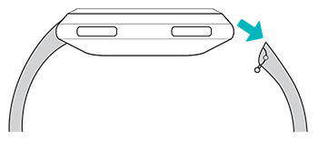

Hey @SVV10, I hope you are doin' fine! Please make sure to follow these instructions to remove and re attach your Versa wristband:
  1. Turn Versa over and find the quick release lever—there’s one on each end where the band meets the frame.
  2. To release the band, push the quick-release lever inward.
   3. Gently pull the band away from the watch to release it.
    4. Repeat on the other side.
    5. To attach a wristband, slide the pin (the side opposite the quick-release lever) into the notch on the watch. The band with the clasp attaches to the top of the watch.
   6. While pressing the quick-release lever inward, slide the other end of the band into place.
   7. When both ends of the pin are inserted, release the quick-release lever.
Hope this helps! Let me know how it goes!

Thanks for your feedback!  I came to determine that the band was defective.  I was able to attach and detach several different bands with no problem.
