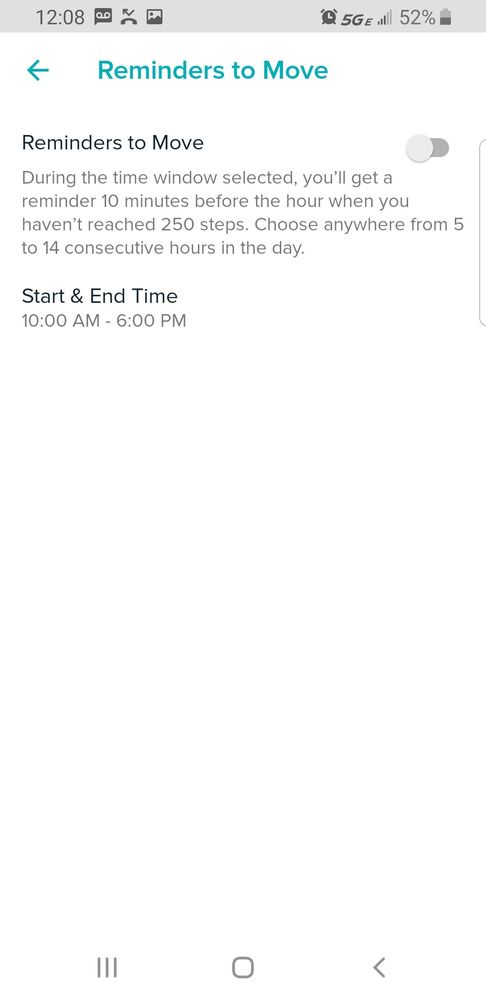

I have disabled reminder to move but I still gets some vibration alert ( n steps left to complete 250 steps this hour). Where is setting to disable this ?

>>Go to the Fitbit App. Tap the image of your device. Under General Notifications, turn off the reminder to move.
I have already done that.
Under Notifications, Calls is turned on (which is okay)
and Fitbit which is ON.
It looks like there is some setting where you setup 250 steps and it is not reached, it will keep reminding every hr. I want to turn this off. I don't see any setting whether I can enter number of steps . In the setting , reminder to move is off
Start and end Time : 10am to 6pm ( since reminder is off so this should not matter)
Is it some kind of BUG ?

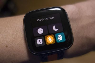

Your Versa Lite is on the latest firmware version. Have you tried putting your Versa Lite in Don't Disturb mode?
On the main clock face, please swipe down, as if you were reading your messages. Swipe down again, and you should get the Quick Settings menu.
You should see a gray bar with a music and a 2 bars icons.
Tap on the 2 bars. There you should find the buttons for Don't Disturb -, Sleep modes and 3 more Icons.
Tap on the Don't Disturb to activate it.
Please let me know how it goes.

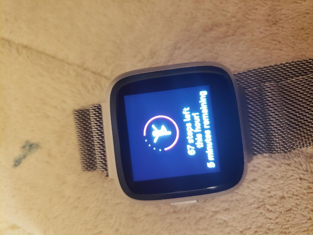

Still I get vibration alert for steps ( complete x steps to reach 250 goals) even I turned on "Don't disturb". However alert is pretty quick so I don't know how to capture screenshots since it goes away very quickly.

Hi @sanjay92 , thank you for your reply and for the shared pictures! Seems that the watch is not taking the settings from the app.
Please uninstall the app, restart your phone (off/on) . Reinstall the app after the phone is back on. Log in and sync your Versa Lite again.
Let me know how it goes!
