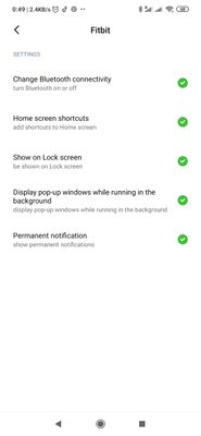

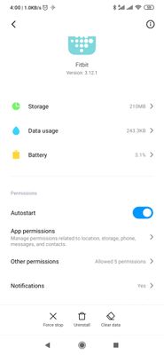

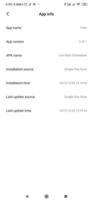

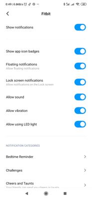

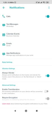

i managed to solve notifications problem for inspire HR and Xiaomi redmi. Here are some screenshots for you guys. I think autostart us important. Persistent notification permission is not obligatory.

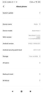

What is OS version of your PocoPhone. im having issue on my PocoPhone

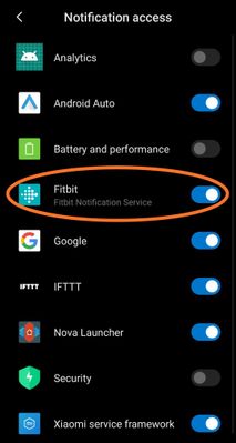

Make sure the Notification Service is running! Go to Settings on your Xiaomi phone and search for 'Notification Access'. Enable the Fitbit Notification Service and restart your phone.

This worked for me using Fitbit Charge 3, just remember to run a sync again after you go through the steps.

@AadipU Did you restart your phone after locking the app in the background, setting auto start on and disable optimization for Fitbit? Worked for me on MIUI 11
