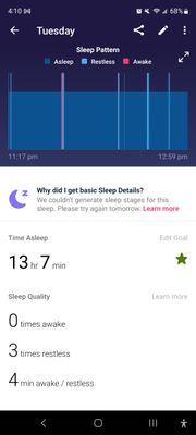

I also have had this same issue with my versa 2
. Sunday after 3p est my watch stopped recording heart rate and did not gain a proper sleep score.
Watch for example says I slept 13 hours last night when for starters I was up until 3am watch says I went to sleep at 11pm.. but also I got a standard "not enough data" chart with basic info. No score or spO2 reading.
I have factory reset, tried holding the button until it turned off and back on again, hit shut down in the settings, deleted Fitbit app reinstalled it, logged out of Fitbit app logged back in, removed Bluetooth connection and re connected all without any fix. Someone mentioned watch faces being an issue but I have not changed my watch face at all in over a year. It use to work now it doesn't. Out of the blue so don't think that has anything to do with everyone's issues.
By the sounds of it it is an update bug which might have to get patched out in another update.. hopefully being looked into currently..
***Update: I've reached out to Fitbit and was told all the same troubleshooting that's been mentioned here. My watch I have had since may of 2020 so it's out of warranty and was given a discount for a new watch as my solution.
