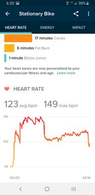

I recently switched from the Ionic to the Versa 2 and I found that when I track a workout, the Heart Rate has a spike early in the workout before it levels off.
I do 30 mins on the exercise bike at a steady pace every morning.
This is a typical Versa 2 workout:
And this is a typical Ionic workout I have in the past:
I bought the Versa 2 because I thought it had advanced HR monitoring but it does not appear to be the case.

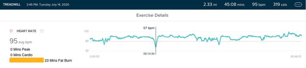

The reason I have stated the above is that I have found both the "Treadmill" and "Workout" exercise apps have issues with heart rate reporting - very low spikes when treadmilling (under resting heart rate of 63 bpm). From two days ago, 57 bpm 15 minutes into a 45 minute session at 3 mph, whereas my app shows heart rate for the 45 minutes to be between 85 and 103 bpm (granted, those are 5 minute averages in the app). But can you imagine a 68-year old man with a viral-damaged heart dropping below resting heart rate when walking at 3 mph?

Thank you for your thoughts and help.  I am indeed tracking it as a workout and then reclassifying it as a Stationary Bike activity.
I'm not sure what you meant by "duplicated in your app's heart rate tracking". I'm using Fitbit and the hr graph is from the app itself.
All that said, I never had this problem when I used the Ionic.  It was a consistent rise and then a plateau.  I am seeing this early spike consistently with the Versa 2.  In fact, this morning, I wore a chest HRM strap along with my Fitbit and you can see the variability in the Fitbit HR compared to the chest strap (using MapMyFitness).
My thinking is that the HR capture in the Versa 2 is questionable, which means the calories burned is questionable and the calorie counting is of course now questionable.

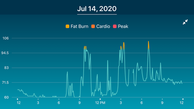

What I meant by "duplicated in your app's heart rate tracking" is in the heart rate tile for the day - not the track shown in the exercise record.
You may not see the granularity you need using that info, as those graphs average HR in 5 minute buckets. My apps HR graph that matches the Treadmill exercise I posted earlier. The dip in the heart rate in the exercise occurred at approximately 2:59 pm. No huge dip because of the 5 minute averaging.

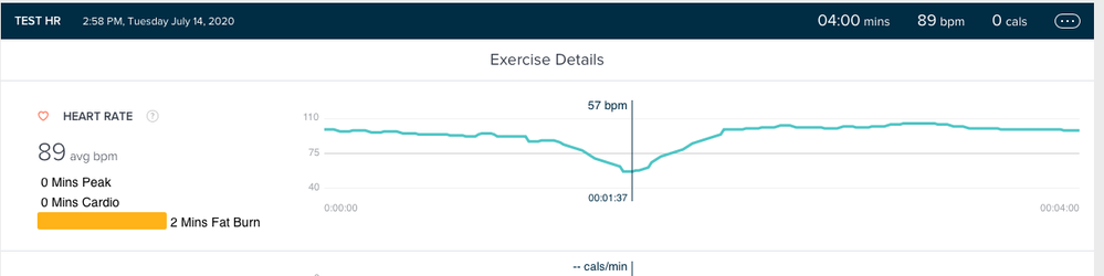

A couple years ago, I created a "custom exercise" called "TEST HR" that I use to report on short periods of time where the granularity can be as tight as one second. I logged an exercise that started approximately 13 minutes into the treadmill exercise for a length of four minutes (the 57 bpm shows for 5 seconds):
So my Versa reported the dip, included it in the exercise record and the daily heart rate data. But did I really have a heart rate of 57, or did the Versa 2 sensor mess up or did the exercise app mess the sensor data up?

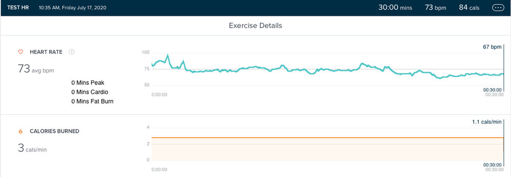

Started this mornings session with a Versa 2 initiated Treadmill exercise for 30 minutes. Stopped the exercise with the treadmill continuing for another 30 minutes. I had hoped it would auto-recognize the second 30 minutes as a walk. I have had walks on the treadmill auto recognized in the past, but had only performed the same tests with a 5-minute break between and with the walk first. I did not get a walk recognized this time, so I created a "Test HR" exercise for the period.
I had a reported 68 BPM seconds before starting the treadmill exercise and the exercise track starts with that. After that it gets a little crazy. Remember, my resting heart rate is 63 and I regularly manually test the device when just sitting at my desk - it is always correct. Just took a 15 second break from typing - 16 beats in 15 seconds and my device was showing 63. Close enough for me. And I occasionally test it at other rates during the day with good results (must be the Geek in me).
Back to the exercise with time into the exercise and the reported heart rate.
  • 00:23 - 55 bpm - remember my resting hr is 63 and I am walking at a 3 mph pace.
  • 01:37 - 53 bpm
  • 02:30 - 84 bpm - expected
  • 07:51 - 151 bpm - 1 beat below my "max" (I'm 68 years old) and I stepped on the rails and manually took my pulse (count for 15 seconds and multiply by 4) - 92 bpm - once again expected.
  • for most of the rest of the exercise bpm ranged between 94 and 107 which is reasonable.
  • 25:30 - 62 bpm - once again under resting hr
  • last four minutes ranged between 84 and 102.
My 30 minutes as "just walking" had some issues, as well, but not to the degree the treadmill exercise. With a low of 62 and a high of 96, the reporting was much smoother but averaged lower than I expected.
