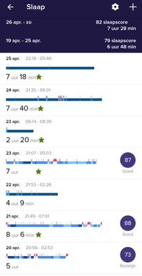

This is my second Versa 2 ... supposedly.  I contacted Fitbit about not getting a sleep score. I had my watch for about 2 months and it wouldn't give me a sleep score. They sent me the instructions to set up, and troubleshoot but nothing helped. I tried a couple of different things I saw online but it didn't solve the problem. I contacted Fitbit ... again after multiple emails back and forth ... telling them to either give me my money back or replace the watch. They did "replace" it but it's still not giving a sleep score. That's the reason I bought the Versa 2 was for the sleep score. So now I'm back to the way it was with the first Versa 2.
The excuse that it's not getting a good heart reading is bull!! If that was the case then I wouldn't be getting a heart rate at all or it would be sporadic. I just want it to work like it's supposed to!!

I started using a skin care ointment for a small 'sweat rash' and by accident I rubbed some of the ointment on my wrist, on the spot I wear my Versa 2. The next morning I was surprised seeing a Sleep Score. From then I started using the skin care *ointment (not a cream or gel, ointments have a higher concentration of oil) daily also on my wrist before I go to sleep and till today I saw my Sleep Score (for two weeks in a row) but then it stopped again.
One of the last responses from support was:"Please note that receiving sleep stages can be affected by a combination of your movement during sleep, HRV data, and personal physiology.", so I guess our "personal physiology" must be weird..
It's 'trail and error' I'm afraid..

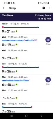

I agree. I’ve now gone over a week without a sleep score. Mostly it breaks my night’s sleep into two smaller segments and the only show the famous colored bars but no score. I even delete one of the segments and enter the proper start or start time but I get nothing. My primary reason for the Versa is to track heart rate, monitor sleep score and track workouts. Since the sleep score doesn’t function, I’ll consider dumping the Fitbit and switching to Apple. My wife is having the same problem with her Charge 5.

 I only get sleep scores and details a couple of days each week, and I don't know what I am doing differently those days to make it work.
It turns out that I just needed to stop telling my versa app that I was going to sleep. If I just let it do its own thing, it tracks it every night with a sleep score and all of the details.
