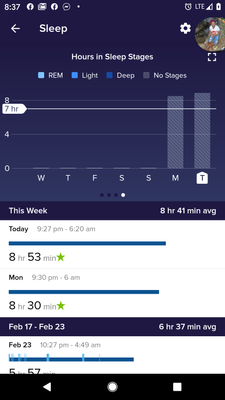

I was used to the tracker on my Flex, so I didn't know that I had to swipe screens in order to get a score until I figured it out by accident. However, I have no data because my sleep hours were not recorded automatically. I had to input them. How do I get it to track my sleep automatically so my score doesn't look like this?

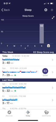

 Heres mine. Two days of nothing ... ? I havent changed a thing from the previous week. Not sure whats happening.

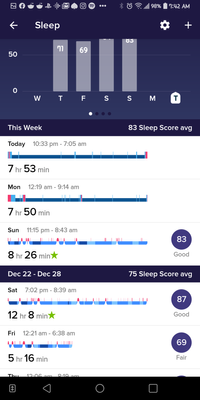

I had a score this morning with data for last night and Monday night. I didn't do anything differently other than maybe tighten the band.
