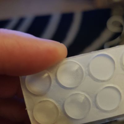

 get these here in the UK they're called sticky dots I think in the US they're called epoxy stickers
I had the same problem my Blaze and Ionic worked fine on my tattoos but the versa 2 wouldn't... however stick one of these over the diode on the back works perfectly and my wrist is heavily tattooed....you will have to take the dot off to charge
You can get them on Amazon or any hardware store
Thanks! I received these stickers with Dome ikea furniture so I could stick one on right away. It seems to work. Normally it has trouble finding my heartrate and now its registering constantly. I am very hopefull for the registration of my sleep tonight, thank you 🙏
Dome = some
Glad they work!
Also I get a pack of around 20 as the dot needs to be replaced every time you charge your versa ... I'm not sure how they react in water I find they stay on when washing my hands or washing up but I don't wear my Fitbit in the shower/bath .. anyway really glad they're working it drove me mad trying to find a solution but thanks to these little dots I get a constant HR reading and accurate sleep scores
Enjoy your versa!
Thanks so much! Today accurate hr, all day. Very happy 😀
