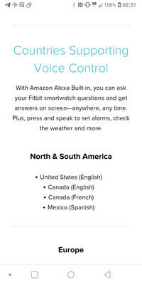

@Sandy0611 Canada is a supported country for Alexa (see help article), I'm not sure who told you otherwise. In fact I personally know someone who is using Alexa on the Versa 2 in Canada without having to change countries.

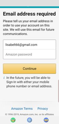

I get the message that my email already exists. I don't understand.
Best Answer12-12-2019 08:03
12-12-2019 08:03
On the amazon alexa sign on
Best Answer12-12-2019 08:20
12-12-2019 08:20
@Belt66 are you using the sign in option, or the create a new account option?
It looks like you already have an Alexa account and I would choose the forget password option.
Best Answer12-12-2019 08:45
12-12-2019 08:45
It doesn't give me an option, it's like I'm a new member.
Best Answer12-12-2019 08:55
12-12-2019 08:55
12-12-2019 08:55
When signing into Alexa, Fitbit sends you to a page on Amazon Alexa.
Do you get sent their?
