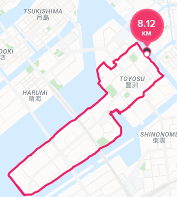

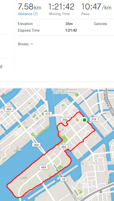

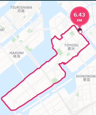

I dont think Fitbit cares or reads these anymore, probably not since the Google takeover. I am 5+ year customer of Fitbit and have owned every single gadget that they released. Versa 2 by far is the worst device in terms of consistency, its just a joke. My partner uses Ionic and it is fairly consistent.
Here is the proof of the rubbish called activity tracking!
On the same track, on two different times:
1) Well far from accurate
2) Too much credit! Making up for the loss in the last one?
3) Strava on the same path is fairly consistent.
So, I've decided that enough is enough, and hence, I am working on writing a program that will help me move all of my data into Garmin. Currently exploring APIs. And once that is done, I will consider getting a Vivosmart 4, perhaps to start with, and then maybe if I like it, I will move on to Fenix 6. Time to bury the Fitbit hatchet, been fair ride, adios!
I will do everything that I can to make this a free app to help people get rid of their Fitbits. I have been held hostage due to my Data, now, I am planning to take that back.

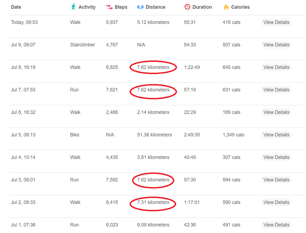

Just to let everyone know that it has been pretty darn accurate for over a week now (except on 2nd July, where it lost 300 meters to Garmin).
Here are the stats /proof for the geeks:
But at this point am too invested into Garmin, so if anyone is still onboard writing a platform agnostic web api or so that can capture and track these metrics, I'm happy to collab (from August-2020).
I will keep Fitbit Versa 2 up until end of this month and keep comparing and report back if there are notable differences.
