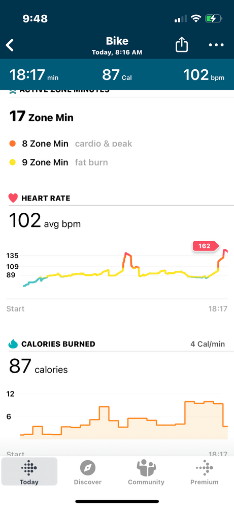

Over the last couple of months my Versa 2 has shown huge, temporary spikes in heart rate (HR). I know that these readings are inaccurate because I would feel a sudden increase of 60 BPMs and the heart rate monitor in the piece of gym equipment shows what I believe to be an accurate heart rate that is significantly lower.
In the photo below from 1/26, note that the spike is square shaped which would indicate an unlikely instantaneous increase in HR.

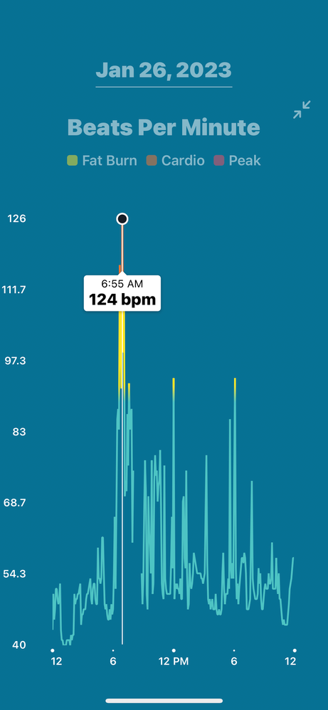

In the photo immediately below, note the HR spike to 162. In the next photo is the HR from the heart rate screen (the one that shows your HR over the entire day rather than just during an activity) which shows a max heart rate of 124 during the exercise period vs the 162 on the HR for the bike activity.
If this is just a difference in sampling rates and averaging then the algorithm needs to be changed to be more accurate.
