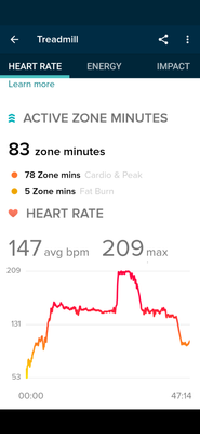

I also had a treadmill run last week where my HR spiked to 209 (according to my FitBit) which scared the crap out of me. I immediately stopped and did a manual check which showed my actual HR was 145. I continued running and my HR on the Versa continued to register a 209 for 7 minutes when it then dropped suddenly down to the 145 range for the remainder of my run.
