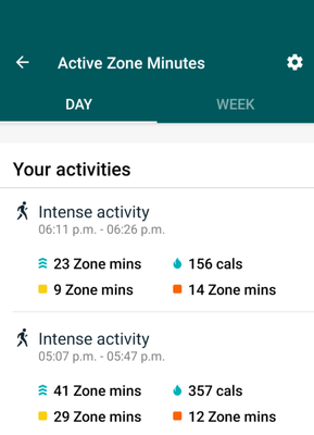

Spent over an hour shoveling several inches of snow the other day and today. Never got above 114 bpm and only received 4 'active minutes.' For me, the HR is entirely inaccurate when doing any real physical activity. If I am sitting and doing nothing, it is usually fine. Otherwise, it's 60-70 bpm lower than it should be. (If only this didn't impact more than the fact I can't even get 'active minutes' slots in a group fitbit-bingo...with the 'easier to get active minutes' thing they've got going on now. *sigh* 😒
