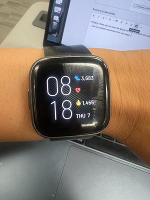

Hi Marre, thank you so much for taking the time to explain the steps thoroughly and I followed the same. Still my device doesn't track my heart rate and shows _ Can you please recommend the next steps. Adding a picture for reference. Please let me know the next steps. IMG_7623 Medium.png
@Sghosh08 You're very welcome! Thank you so much for following the steps recommended and for the image attached.
In addition to the steps you have done so far, please try the steps below:
  1. From the Today tab in the Fitbit app, tap the devices icon at the top-left corner.
  2. Tap your Fitbit device image.
  3. Near the bottom of the page, tap Sync Now.
If the above doesn't work, please restart your Fitbit device once again as suggested here How do I restart my Fitbit device? Note: Restarting the device doesn’t delete any data. If the restart doesn't work try to change your clock face. If this fixes the issue, you can change your clock face back to the original clock face.
