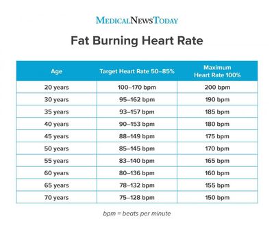

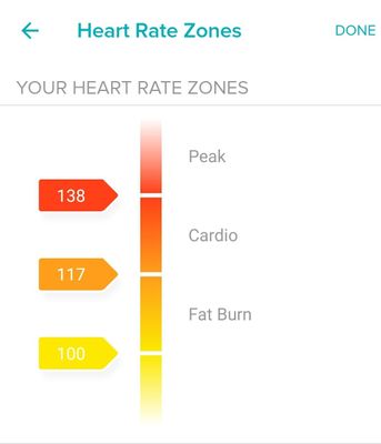

Thank you for your solution. I tried the solution but my ranges are still off. This is what it is now:
However this is still wrong compared to what I had previously (94 fat burn, 132 cardio, 160 peak) and based on the chart below that matches my age group, I am 31:
@lawrenc28 -
What is your resting heart rate. That value is used in the new formula.
Your stated values for what you had before the firmware update are real close to what my calculations are using 4/5 rounding - 95, 132 and 161 using the male/female max of 220 - age.
I'll take your resting heart rate and run the numbers using the traditional male/female max against a female only max for both traditional and the new Heart Rate Reserve formulas.
