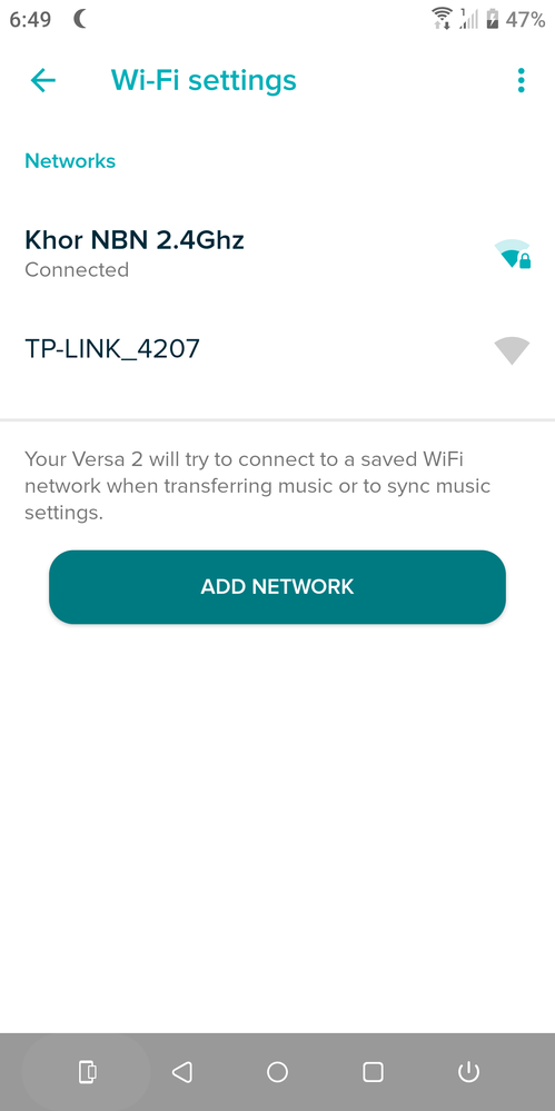

Ok, so I managed to connect both my devices but I am not sure if it will work for everyone.
The issue is not the trouble shooting steps, it's the connection with the Router and the device. I recently switched to Optus NBN and I had my Fibtit Aria working for a while with an Asus Router RT-AC-88U. However, after a while it stopped connecting.
Note: I connected my optus router to give internet to my asus router since the wifi coverage is always so bad with telco equipment.
Then I switched to NBN and my other router worked for a couple of weeks before it stopped providing internet. Optus controls the DHCP server which gives the IP address to your device. So this frustrated me and annoyed me, I had to disconnect my Asus Router. Now as technology has improved, the wifi range of the Optus NBN modem coverage is not bad.
I had a feeling this would work, so I tried connecting both my devices, and it worked. I am not sure why but I know for a fact that when you use the original connection to your internet provider, it connects.
I hope this helps everyone with this issue.
