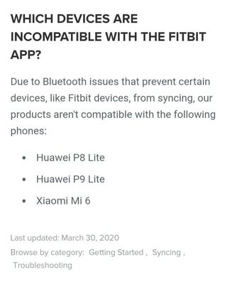

Haha @Pake25 , here I was wondering why it had worked once and sorted your issue and not for me 🤣 according to Fitbit, there are only 3 or 4 phones they class as 'incompatible' and mine isnt one of them.. but my phone isn't on the list as fully supported either.. to me it's either compatible or it isn't, and so all those 'not fully supported' phones should be added to the incompatible list and the list should show before any Fitbit purchase can take place. Why would anyone in their right mind buy something that isn't going to work properly.. infuriating..

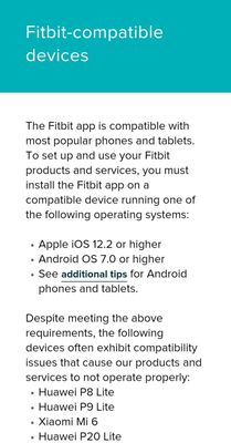

For anyone else coming to this thread with a similar issue here's the link to check your phone's (alleged) compatibility with a Fitbit
https://help.fitbit.com/articles/en_US/Help_article/2315

Honor 8x phone is not on Fitbits supported device list..

As I've mentioned here, Fitbit products are compatible with most devices that have the following operating systems: Apple iOS 12.2 and higher, Android OS 7.0 and higher.
Please keep in mind that when a device is not supported (not listed in the article I've shared with you) and does not meet the require OS we cannot guarantee its functionality with the Fitbit app. It might work at a certain time and then it can stop working out of nowhere after an update. This is because the app is not optimized to that device and any change could impact the performance. The officially non-supported devices due to Bluetooth issues that prevent certain devices, like Fitbit devices, from syncing, our products aren't compatible with the following phones:
